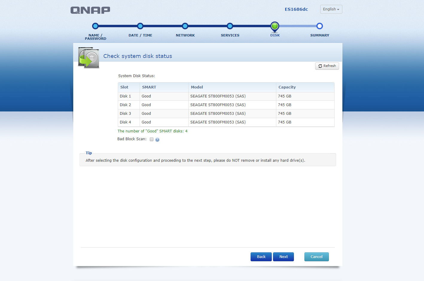

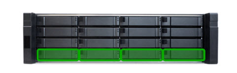

The QNAP ES series NAS is an enterprise-grade storage solution that comes with dual active-active controllers (single box high availability). In order to provide the actual failover on multiple controllers, dual-ported SAS drives* are required for the ES series NAS. Note that at least 2 SAS drives have to be installed on disk tray #1 to #4 (as indicated below) respectively for installing the QES OS.

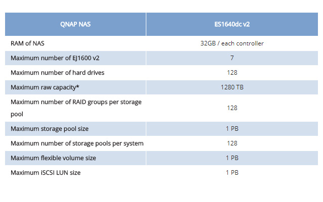

*Maximum raw capacity will base on the maximum capacity for each drive, QNAP Enterprise Storage support up to 128 drives in a set of storage system.

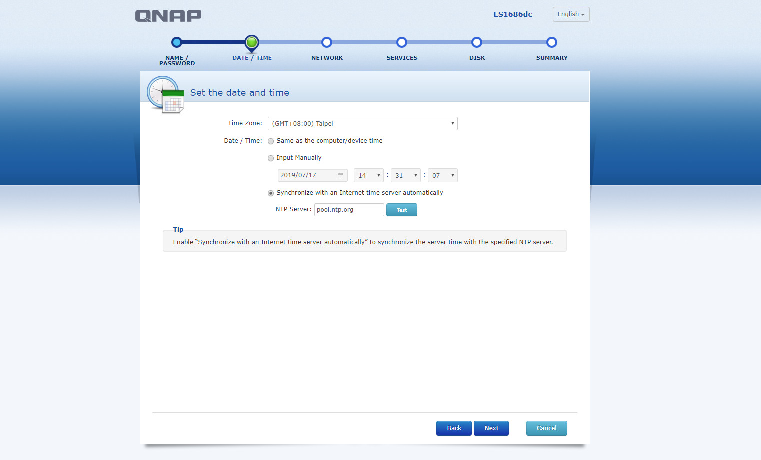

System Configuration

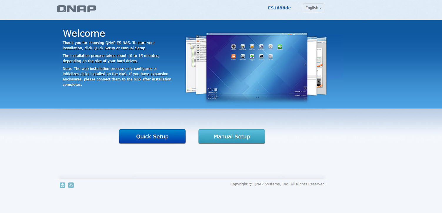

Setting up your NAS and installing the OS only takes a few simple steps

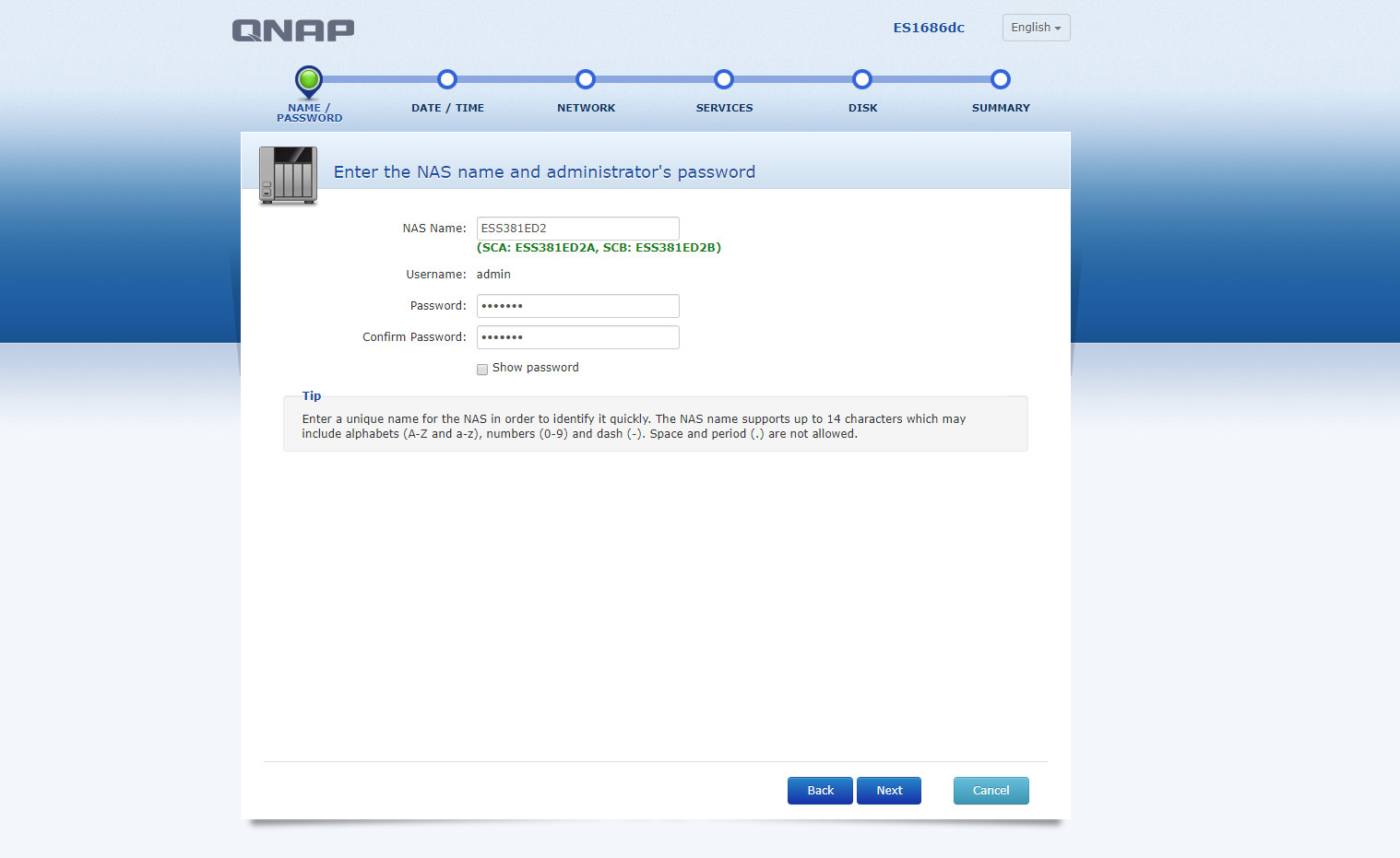

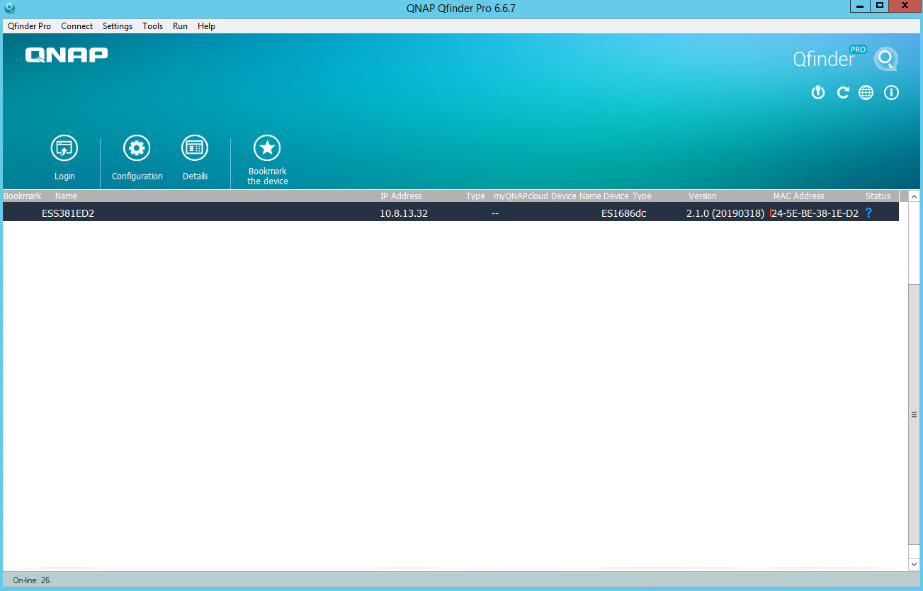

1. Download Qfinder Pro
Qfinder Pro is a utility which helps you to quickly find and access to your QNAP NAS in the local network. Simply install the Qfinder Pro on your computer, open it, and double-click on your NAS, and then you will be redirected to the initialization screen. Download the latest Qfinder Pro for your Windows, Mac or Linux here

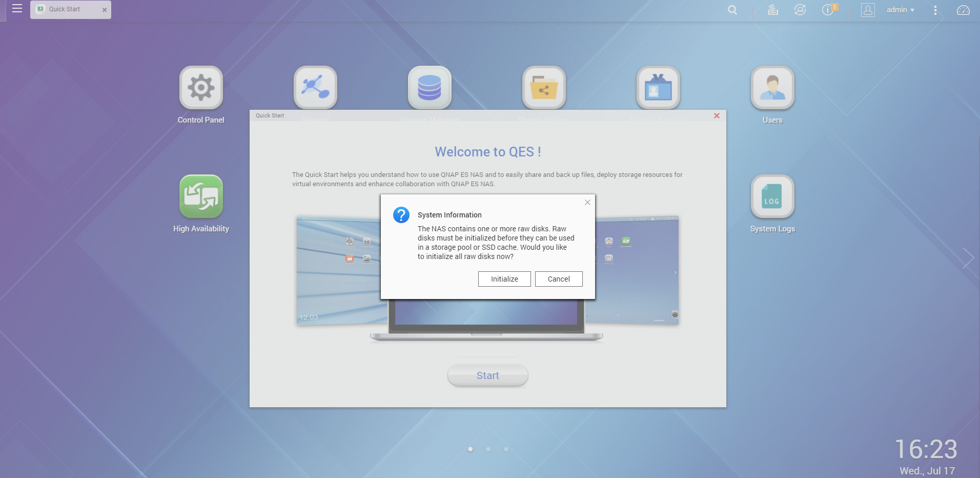

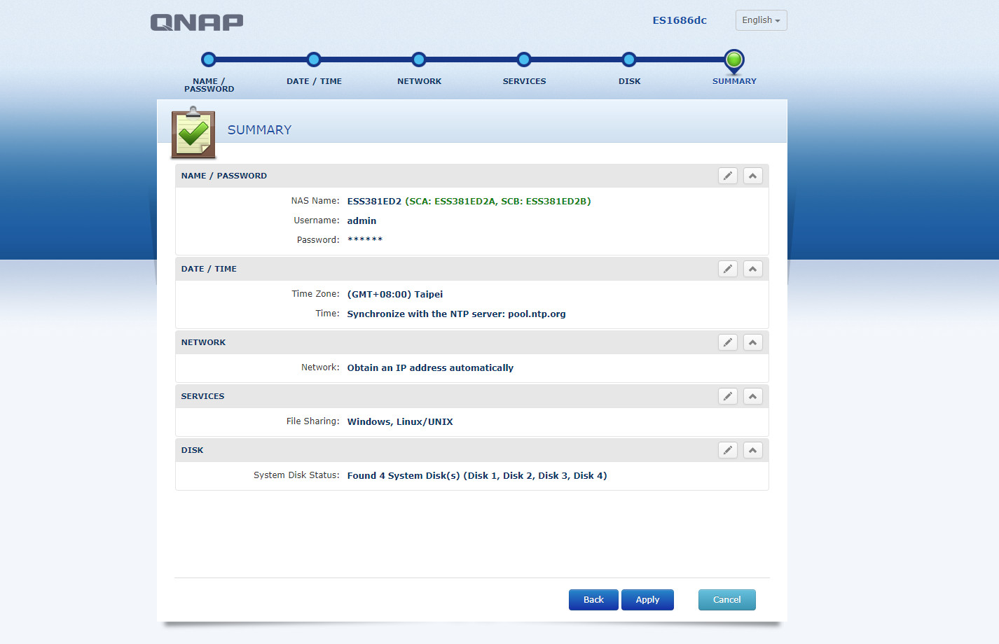

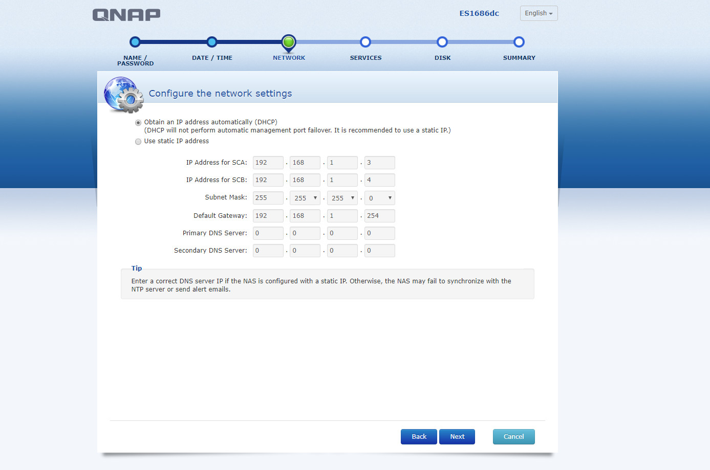

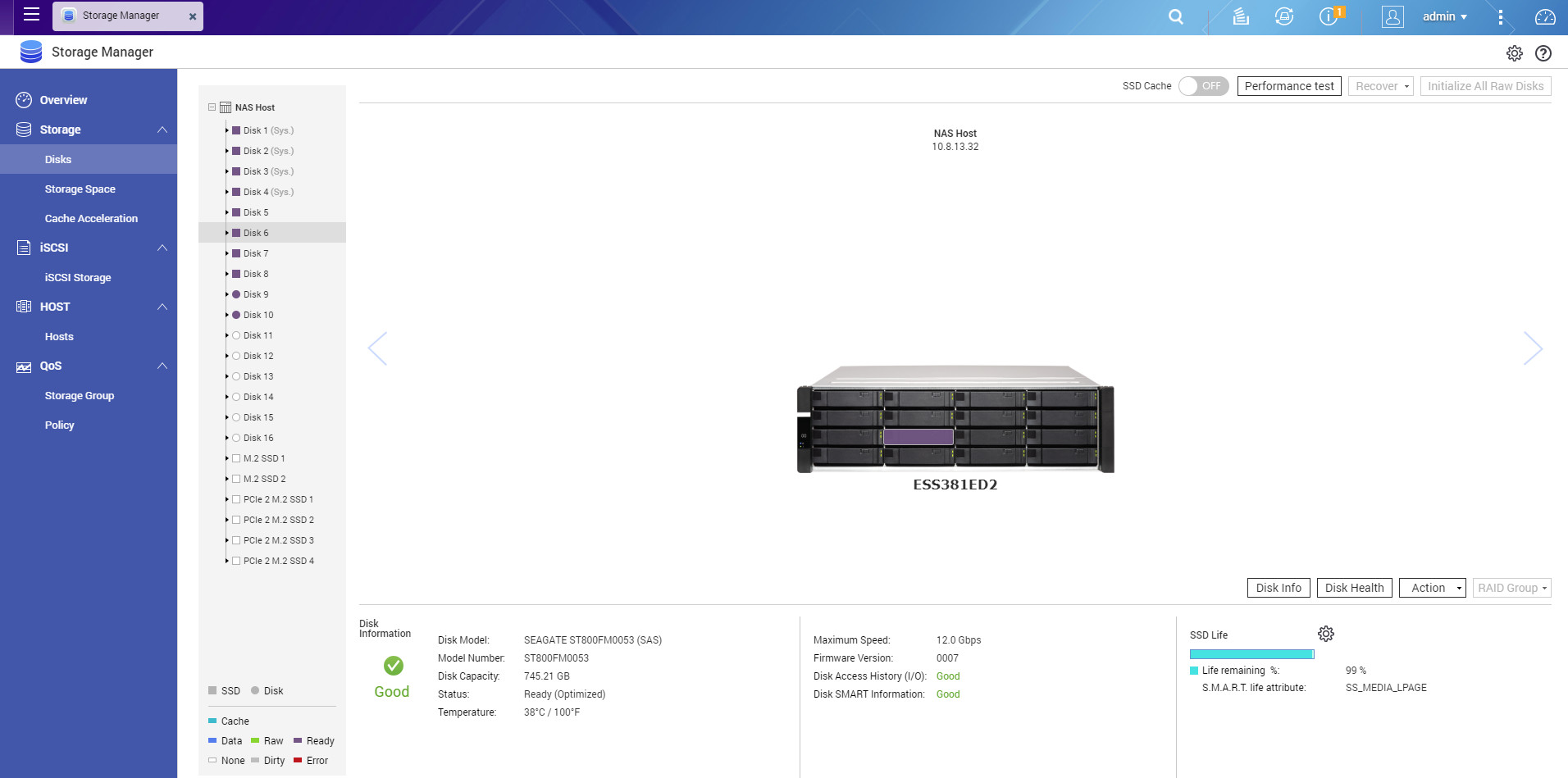

2. Initialize your NAS System

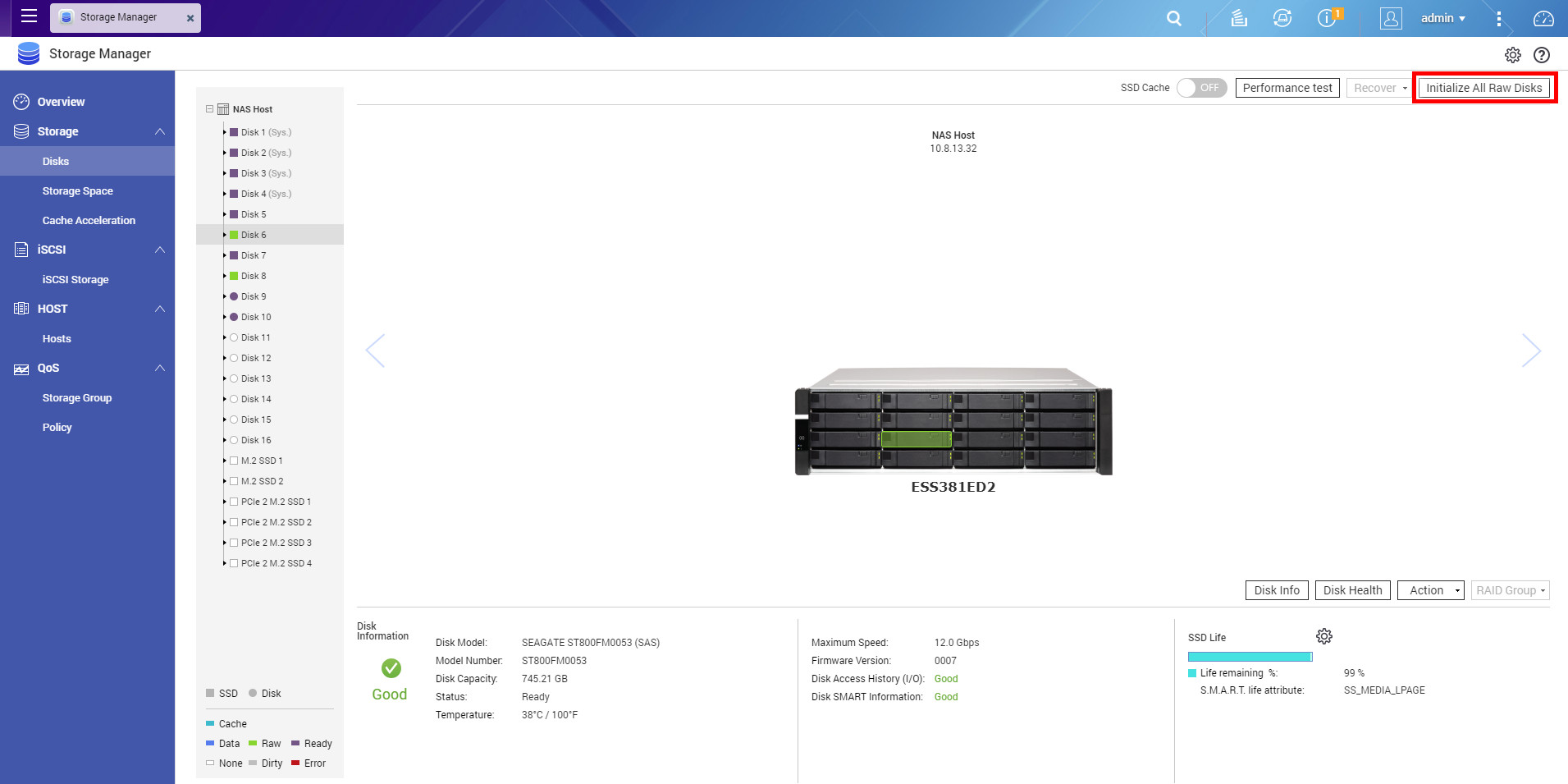

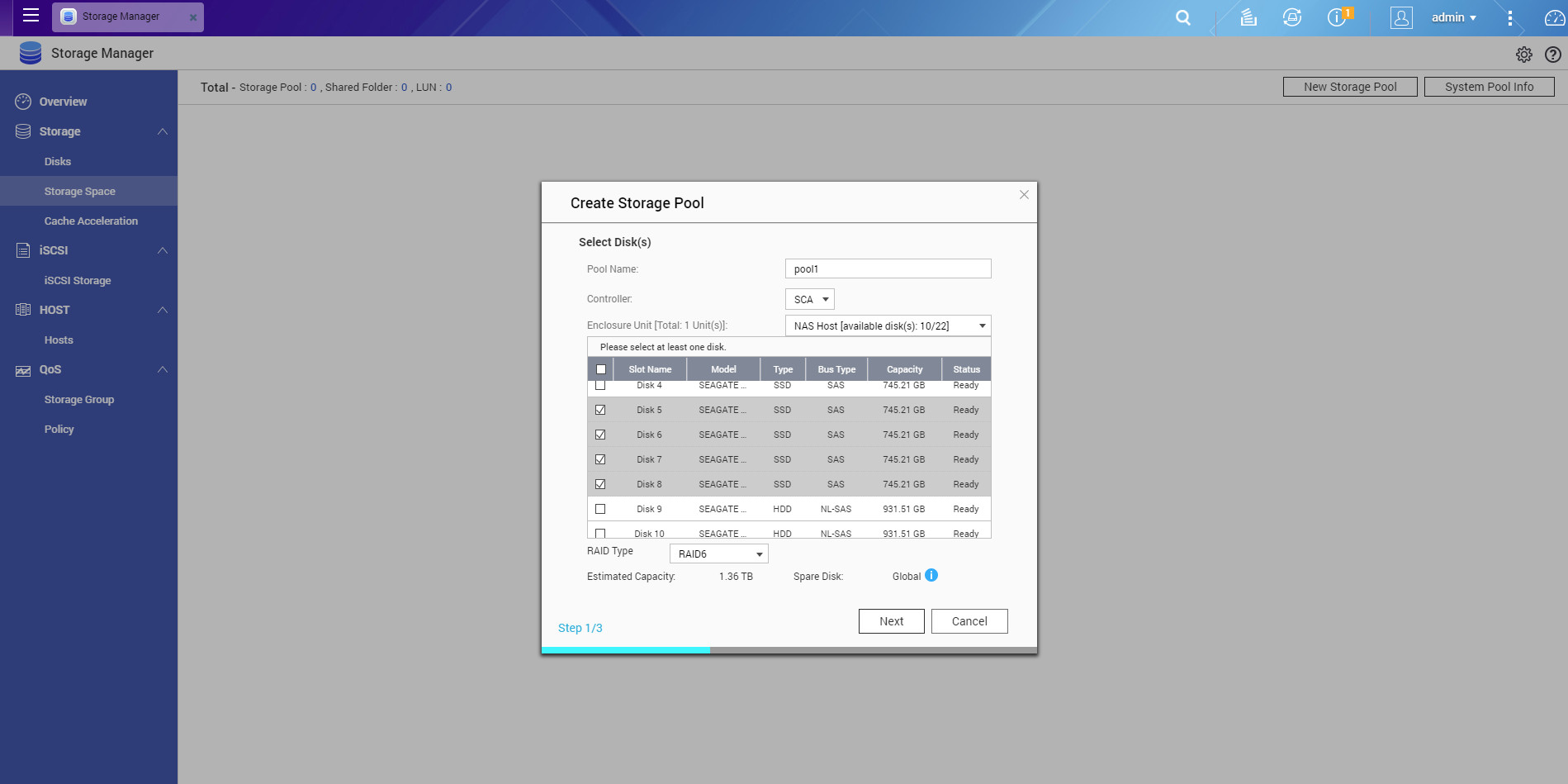

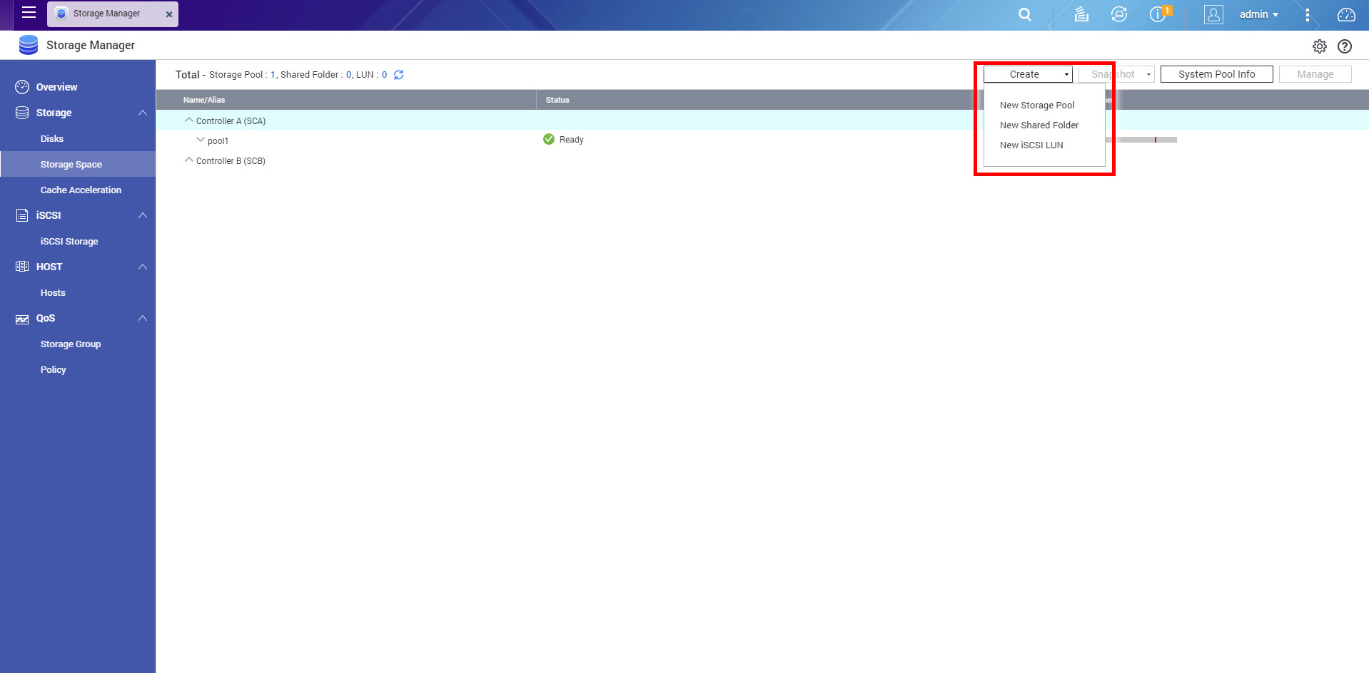

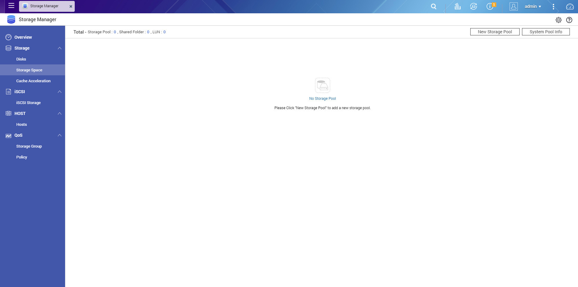

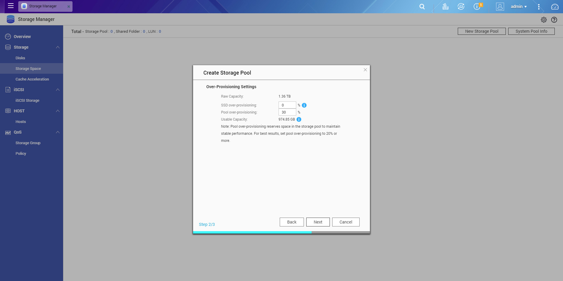

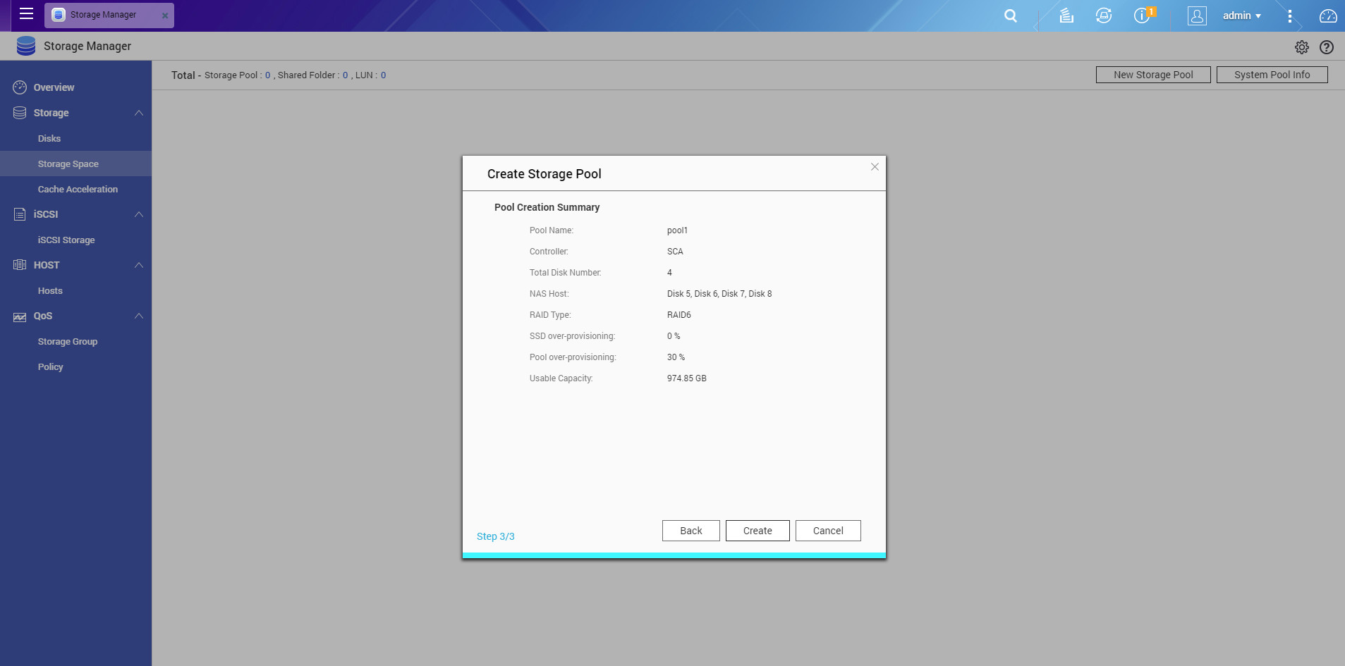

3. Create the First Storage Pool

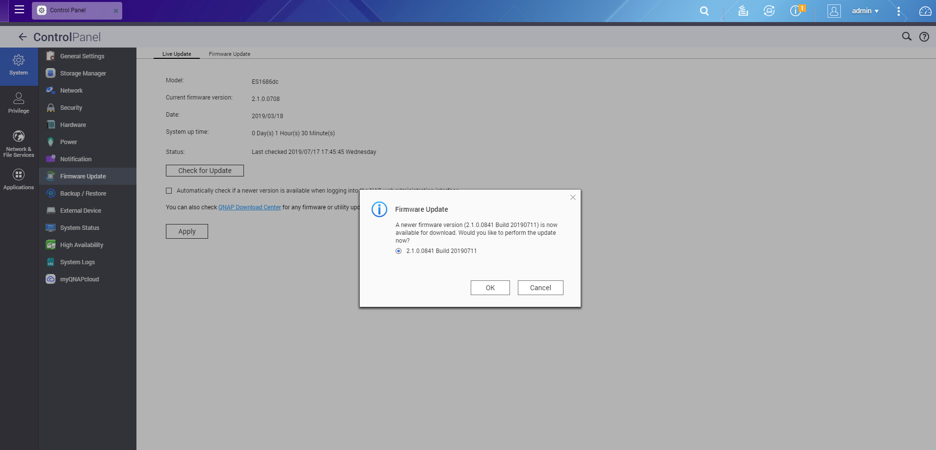

4. Check for Updates
After the system has been properly configured, it is important to keep your system up-to-date. You can simply log into QES, go to [Control Panel] > [Firmware Update], and manually click [Check for Update] to see if there's any new update for your NAS system. In addition, if live update is enabled, system admin will be notified everytime when logging into the QES web portal.
Note: QES supports optional rolling update of firmware, one system controller is still on service while another one updating firmware.
